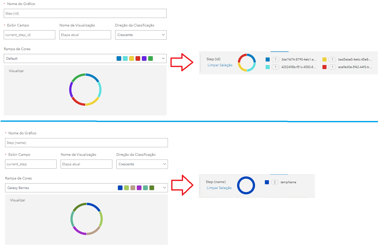

I'm trying to create shared charts in Workflow that show me which step the job is in.
When I use the "current_step_id" field, I return the step ids (expected behavior). However, when using the "current_step" field, I return "tempName" instead of the step name.
Is it possible to return the step name instead of its id? If yes, how?

This is a known issue in current releases of Workflow Manager. It has been addressed and will be working in the February 2024 ArcGIS Online release as well as the Enterprise 11.3 release. Unfortunately, there is not a workaround for this issue.
Let me know if you have any questions.
Jonathan

SMH-Rio
Hello, Jonathan.
We just have to wait for ArcGIS updates to fix this problem.
Thank you for your help.
