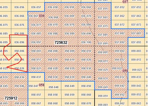

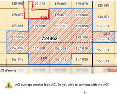

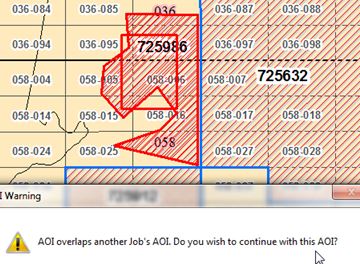

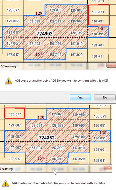

Problem Recap:  Overlap warning message when creating an AOI close, but not touching an existing AOI in WMX.  AOI overlapping is disallow in settings and users are prevented from selecting features outside job AOI.  Warning appears every time a user try to create or recreate an AOI in another area.
Findings:
  • Message appears when creating a polygon using any drawing tool close to an existing irregular AOI or creating an irregular new AOI close.
  • Apparently the problem resides with the extent of the polygons instead of the explicit boundaries of the areas.  If the AOI to be created is out of the extent of any existing AOI, you will be allow to create it.
