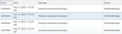

And at the same time, on our ArcGIS Server Manager, it fires dozens of warnings like these within a second -
I saw these warnings when a person clicked on 'proceed' and it got stuck. But most of the time, the operation runs through even though these warnings are genereated.

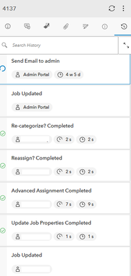

Another thing I noticed is - when I check on History in the Detail pane for a specific job, there are steps that say running even though they ran successfully. This happens in our closed jobs as well.
