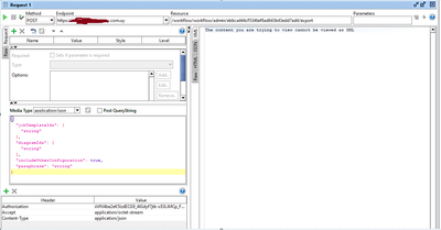

I have tried https://developers.arcgis.com/workflow-manager/api-reference/rest/export-workflow-configuration/ with no luck
any help is welcome
