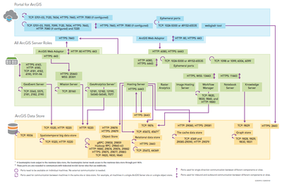

The documentation for this Product is lack luster to say the least. If ESRI could give us a better idea of where 13443 needs to be opened and the communication needed, aside from the huge port diagram, that would be great. For instance, does 13443 need to be opened from the web server hosting the Web Adaptor to the internal server hosting ArcGIS Server and the Application.

Thank you for the response. Just an FYI, we had to open port 13443 from WA->Portal and any other server touching WM in order for this to work properly. Looks like Portal tries to reach back over to the WM to grab a token and authenticate the license properly, then it will load the App page correctly.
One thing I picked up from watching the training video (trying to grab some extra configuration nuggets) that was also not presented by support, was the HealthCheck url for WM. If this isn't working after the initial configuration, obviously the app will not.
This diagram, IMO, is very hard to follow. If the Architecture does not match this diagram, (i.e. Web Servers | WA up top as the Web Tier and Enterprise in the DMZ), the traffic flow from WA is not clear, especially 13443.
