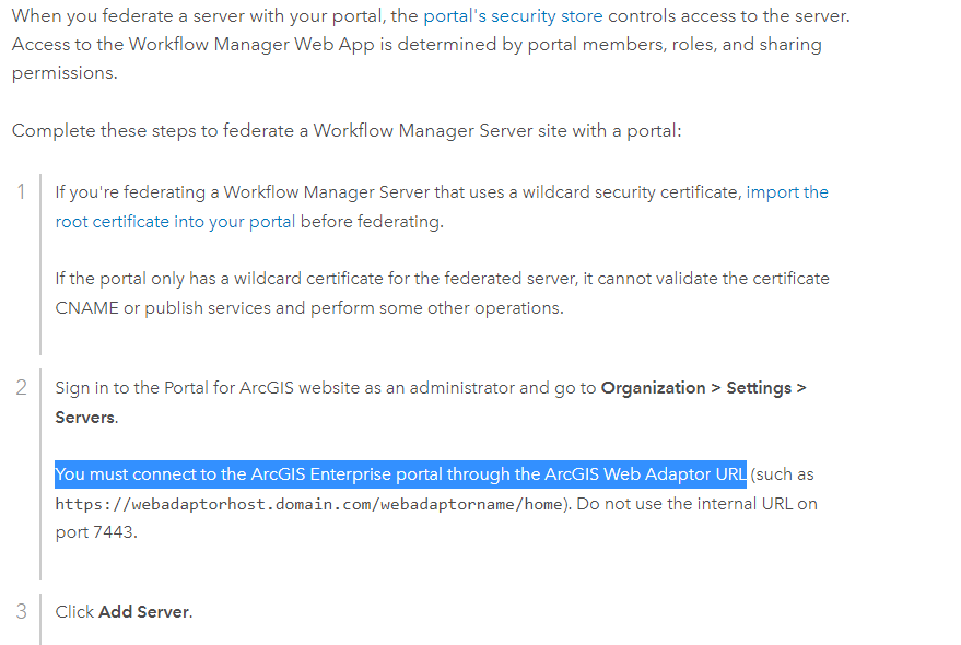

Hello
While trying to federate Configuring Workflow Manager Server with an ArcGIS Enterprise portal it is mentioned in the ESRI documentation that You must connect to theArcGIS Enterpriseportal through theArcGIS Web AdaptorURL. Please find below screenshot for your reference.
More info here
I have tried passing server url along with port name while federating and found that it does not accept and says invalid url.
I was thinking if there is any other way out. If anyone has tried without webadaptor url.
Please share your thoughts on this.

Hi @RaghavGupta
That line in our documentation is specific to how you access the Portal site when you go to federate the server. So, you wouldn't want to go to machine.domain.com:7443/arcgis but instead go to machine.domain.com/portalwebadaptor. This isn't a Workflow Manager requirement, it's a core ArcGIS Enterprise requirement. See step 2 here: https://enterprise.arcgis.com/en/portal/latest/administer/windows/configure-servers.htm
For the actual federation of the server, there is nothing different for Workflow Manager Server than what is in this core ArcGIS Server federation doc: https://enterprise.arcgis.com/en/portal/latest/administer/windows/federate-an-arcgis-server-site-wit.... If you meet those requirements, there shouldn't be any issues on our side.
If you can't federate using the port, I'm guessing that Portal cannot communicate with ArcGIS Server using that port and that's why it fails. But you'll need to look at the Portal and Server logs to sort out that piece.
