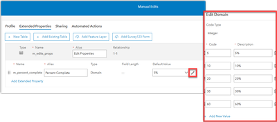

First, you would add a field in a new extended properties table on the job template. I like to prefix my tables and fields so I don't accidentally hit any reserved key words or duplicate table names in my workflow item. Then set an integer domain for the percentage values you wish to capture throughout the process.
Once that is set up, you would use an Update Job Properties step in your workflow at any point you want to update the percent complete value. You can use Arcade but since we have a domain, you can also just set the appropriate value for each step. I would uncheck the Visible (Editable will uncheck too but that is ok) box, delete the user prompt, and ensure it is set to run automatically so that this step will run through without any user interaction.

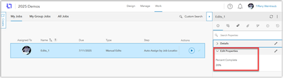

You should see the update in the job properties pane as you work through the job.
