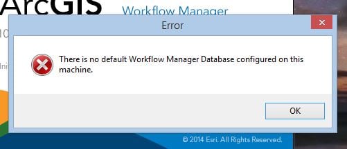

7. Tried opening 'Workflow Manager' received following error:
which was expected as I had not configured a database connection yet.

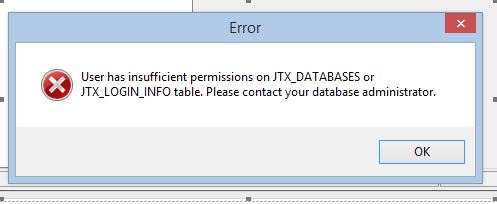

After this when tried connecting to the new Workflow Manager Database node that was created, I received following error:
Here is what I have tried or checked:
1. Granted SELECT, INSERT,UPDATE,DELETE explicitly on the tables in the error message to these users - Did not help
2. Granted SELECT, INSERT,UPDATE,DELETE on WFM database (WFM_PROD_DB)  to these users - Did not help
3. In SQL Server ran queries against the tables in error message by connecting as problematic users and the queries returned results.
4. Created connection to WFM database (WFM_PROD_DB) from ArcCatalog with above mentioned users and checked if they can view the tables in the error message and they could.
I am not sure if I am missing something or doing something incorrectly. Any help would be much appreciated.

NishiMishra
One more thing I forgot to mention, every machine on which you are connecting to this database - you need to set this database as default database. The instructions for the same are Changing the Default Database in the Administrator—Help | ArcGIS for Desktop

NishiMishra
Hello,
It seems the SQL login - Workflow Manager Connection credential - Workflow Manager Username  mapping may not be correct.
You would have run the Post Install with the schema owner credentials which added the Workflow Manager Connection in Administrator on your machine and your windows username was added to the Workflow Manager database as a user and given Administrator Privilege. Thus, the mapping of your SQL login - Workflow Manager connection credential - Your Workflow Manager username is correct and that's why you are able to login on your machine.
You could
I suggest you create 2 sets of SQl logins one for the Workflow Manager Administrators and other for Workflow Manager Users who would not connect to the database in Workflow Manager Administrator.
  1. Add the Windows login of all users(Administrator and Users) who would connect to this database, to Workflow Manager database as Users.
  2. Add the connection with the Administrator login and distribute that .jtc file to the Administrators.
  3. Add the connection with  User login and distribute that .jtc file to the Users.
If you must have a separate SQL login associated with each of your Administrator and Users. This would be recommended only if the above option is not acceptable.
  1. Create SQL Login for each of the Administrator and Users.
  2. Add the connection with the Administrator login,
  3. Add the Windows login of all users(Administrator and Users) who would connect to this database, to Workflow Manager database as Users.
  4. In Workflow Manager Administrator, Open User Properties from the context menu on database connection.
  5. Select the Option "Each User will connect with their own database login"
  6. Add the User and map the SQL login with the Windows user name Adding a WMX Database connection in the Administrator—Help | ArcGIS for Desktop ,
You can add only the username as well and the users can provide the password in Client Application by Setting the database login Using the Edit menu—Help | ArcGIS for Desktop
Some more information about Users and Groups, deploying a Workflow Manager system and Using domains:
Users and groups—Help | ArcGIS for Desktop
Deploying a Workflow Manager system—Help | ArcGIS for Desktop
Authenticating against domains—Help | ArcGIS for Desktop
Hope this helps,
Thanks,
Nishi
