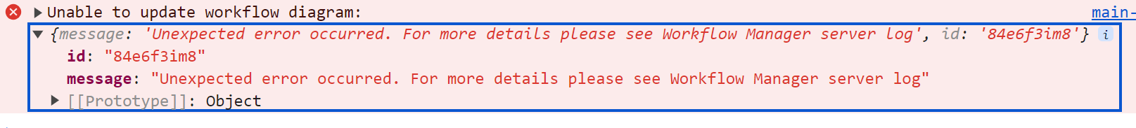

I am currently editing a diagram (Arcgis Enterprise 10.8.1 with the role workflow manager hosted). I am adding steps to it, and it allows me to save up to 105 steps. However, when I try to save the 106th step, it fails and specifies that there is an error. However, upon checking the error log in the server/manager workflow, there is no record of the error. Could it be a limitation on the number of steps allowed per diagram?
This is the message:
As i said, no record on the log, so I'm essentially flying blind.

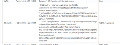

It may also help to show the error message you see in the server logs. Based on your Postman error, you could actually be hitting a limit on the Workflow Manager side. So it would be good to know if you see this error below or an error for the applyEdits endpoint (which could be what @ElizabethLRodriguez mentioned).
Quick Edit - when we log that unexpected exception error message, we should always have a corresponding message in the server logs with more details. If you truly don't see one, that might merit some investigation as well.
