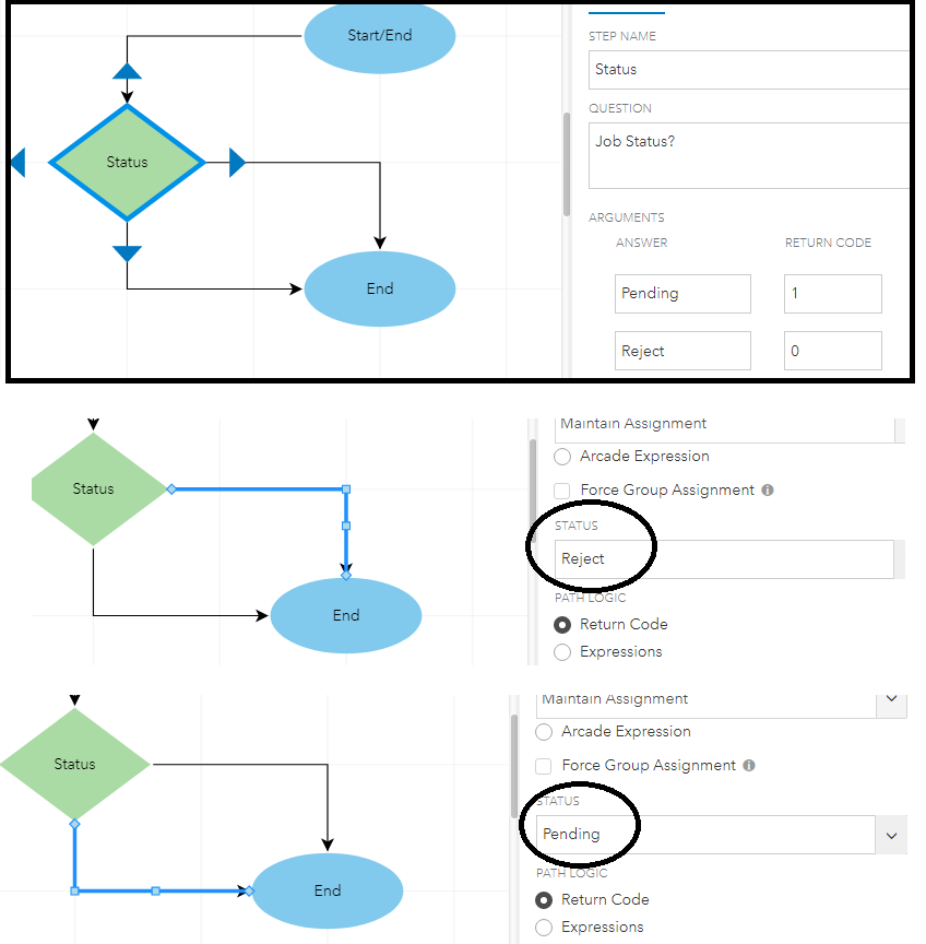

Based on the job, we have defined different 'status' codes like 'pending', 'reject', 'return' etc...
After completing the job we want to retain the status defined in the "paths'.

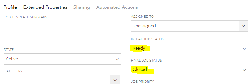

After the completion of job, currently it is overwriting the status as "Ready" which is defined in the template under INITIAL JOB STATUS
"Maintain Status" option is useful for us to extract the reports like, how many jobs are 'rejected', 'pending' are 'closed'.

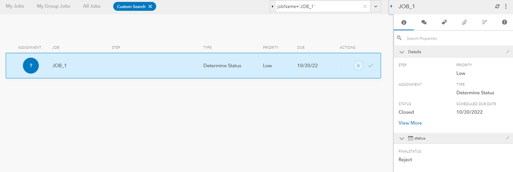

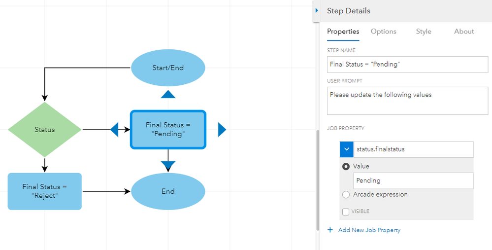

In the meantime, one option you could implement would be to store the job’s ‘final status’ as an Extended Property in your job template.  Once you have determined the job’s status in the ‘Status’ step, you can use an Update Job Property step to update the Extended Property before closing the job.
You can then access that information after a job has been closed to generate reports.

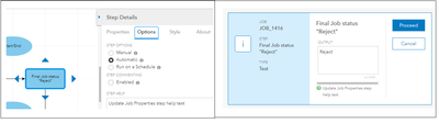

We have tried to implement to store the job’s ‘final status’ as an Extended Property in job template. Facing the following challenges.
1) We have set the "Update Job Properties" step option as "Automatic".
2) When executing the step, it is still prompting user click "Proceed".
If "Update Job Properties" step set to "Automatic", user should not see dialog box (If possible, please consider this option also in product roadmap)

I believe you may have already discovered the solution, but it may be useful for others:
I had the same problem with the step being executed even with the "automatic" option, and I discovered the solution here:
"If the step's User Prompt and Step Help parameters don't contain values, the step completes automatically."
Source: https://enterprise.arcgis.com/en/workflow/latest/help/start-end.htm
Removing the user prompt and step help in the manual step made it run automatically.
