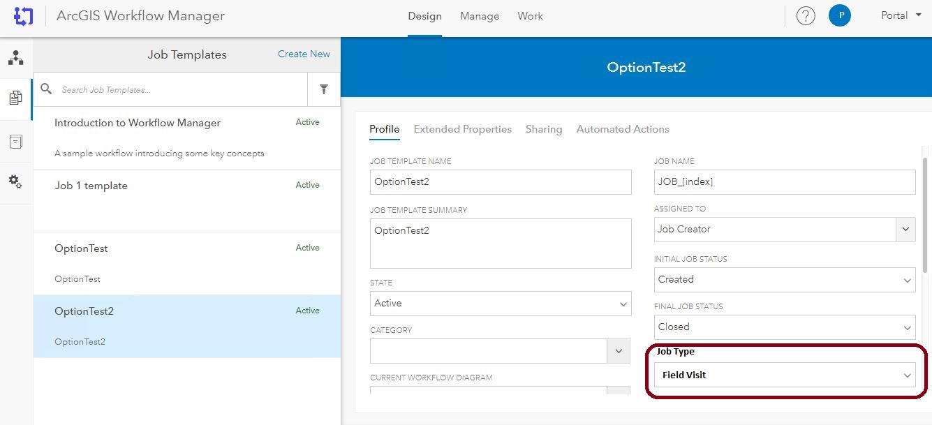

We are using ArcGIS Workflow Manager Server (service-driven). Is there any possibility to "Customize JobTemplate".
Requirement is to define our own fields and admin will set/update these custom fields before creating Job.
For Ex: We would like to add "Job Type" which will show a drop-down with possible values like "Field Visit" & "No Field Visit"
Please find enclosed screenshot for reference. Thanks.

The best way to accomplish this will be for the admin to setup an extended properties table while they are configuring the job template with the fields and values they need. There is not a way to add or modify those existing core job template fields.
Extended (and related) properties tables though were specifically created so that users could add job specific information such as this to the job. https://enterprise.arcgis.com/en/workflow/latest/help/create-extended-properties.htm

Project requirement is to (before) create a job with user created or pre defined values and the job should be assigned to the user (field staff).
As suggested we are planning to implement 'Update Job Properties' step auto run as the first step in a workflow diagram.
