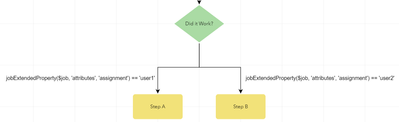

Instead, I created an Extended Property attribute with a domain of user1 and user2 (but you could use a field with Pass and Fail as the values). I tried a branching logic based on the usernames using the following and it routed along the correct path based on the user selection:
Proceed to Step A : jobExtendedProperty($job, 'attributes', 'assignment') == 'user1'
Proceed to Step B: jobExtendedProperty($job, 'attributes', 'assignment') == 'user2'

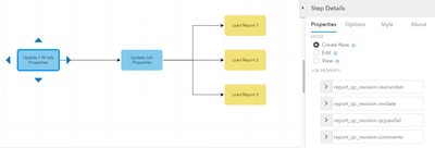

Here are some screen shots of my process:
The path configuration to move to the next step is:
jobExtendedProperty($job,'report_qc_revision','qcpassfail')=='Pass'
(A fail would move to a different step not pictured above)
The branch split to the various reports can be an AND/OR situation - and may not happen at the same time.
The process would move on and meet up from the report branches after they are loaded.
I feel like I am missing something really small and really annoying . . .

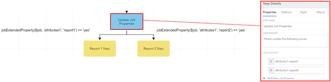

The only thing I can see potentially is that the code for your domain is not the same (e.g. 'yes' vs. 'Yes'). I ran through a test with the following setup:
Then I have an Update Job Properties to select Yes or No for the 2 reports and then configured the paths with the expressions below:

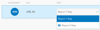

That is successfully routing to either Report 1 Step or Report 2 Step based on selecting Yes for the corresponding job property.
It even works if both are updated to 'Yes':
