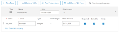

I gave your workflow a go with a 1-1 table with an integer field named like yours below:

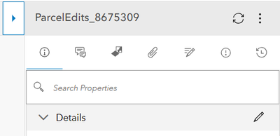

The job tile does not automatically refresh the name in this instance, so you may need to hit the refresh button in the job details panel or run your search again to see the updated job name. If you are combining the number with text such as 'ParcelEdits_', you may need to modify your expression like so
'ParcelEdits_' + jobExtendedProperty($job, 'serviceorder', 'so_num')
This results in a job name like this:
