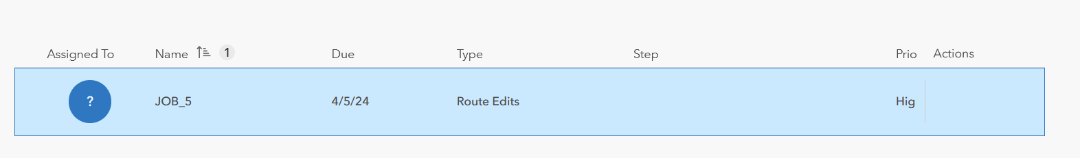

I'm curious if anyone has attempted to use Workflow Manager for 11.2? I'm not able to see any actions for any of my jobs, even the introductory workflow does not have any actions. Anyone experience similar?
This is assigned to myself as well.

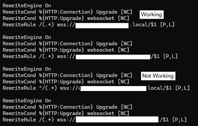

Thank you for the response, I did actually find a WebSocket issue, in the console, it will send random Notification requests out to the Workflow Manager, but that is it, I'm not entirely sure what these are requesting, but they could be the issue!
It seems to be adding the wss onto this http request:
A working request:
Reverse Proxy Setup:
Very curious what could be happening, as the web sockets are forwarded, the only difference is the https in notebooks, and http in the workflow.

After doing some more investigation, you are completely right, it turns out that the RewriteRules are currently causing some issue. Apparently the order matters, and I cannot currently find a way to combine these, any chance you would have an idea?

As another update, I'll go ahead and mark your suggestion and a comment I make as a solution.
It turns out that the location was too ambiguous, and I need to make a change to allow for a distinction to be made within the reverse proxy, with both enabled, it looked for anything in the root of the proxy so /, instead, I needed to specify the server it was looking for with /server/ shown here:

The solution to this was allowing webhook traffic over another passthrough on the reverse proxy. I'm not entirely familiar with load runner, if that is a load balancer or reverse proxy, you will need to enable secure websockets, the wss:// requests, through it in order to accurately route these requests. You can verify that these are the causers of the issue by using your browser console and monitoring websocket requests to verify if everything is passing through correctly.
