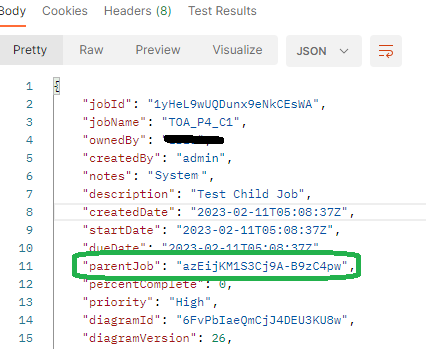

Using 'ArcGIS Workflow Manager API', when we pass the child jobid to 'getJob' method, we are able to see 'parentJob' id in the results.

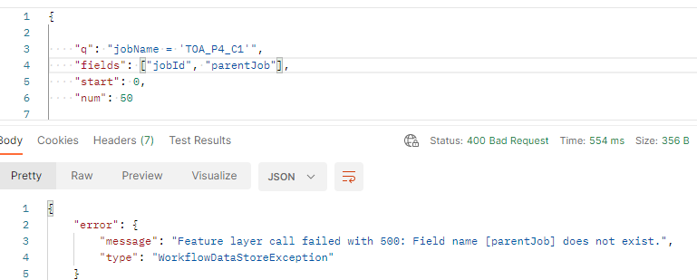

When we try to use 'searchJobs' method and pass the fields parameter with 'parentJob', getting error
If we exclude 'parentJob' in the fields parameter, getting results.
Ex:  "fields": ["jobId"]
We are experiencing the same behavior when we use "ArcGIS API for Python" also.

After spending a lot of time on this, found that "parent_job" is returning valid results.
e.g. "fields": ["parent_job"]
Apparently "parentJob" was supposed/expected to work, as it was part for "getJob" API results.
