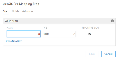

Requirement is to open map in ArcGIS Pro.
We have 20 different maps and to open maps we have to create 20 different flows and pass the map name(hardcoded value).
Instead can we have an option to pass the map name as parameter using 'Arcade Expression' either from 'Extended property' or from 'Userdefined setting'

My organisation needs this functionality as well. It would be even better if it was possible to set ALL the parameters for the Open Map step using an Arcade Expression. Arcade Expressions can be used for most of the settings in other Workflow Manager Steps, so it would make sense to enable that same functionality here. At the moment we need to create ten separate Open Map steps in our workflow to work-around this issue and it is difficult to maintain.
