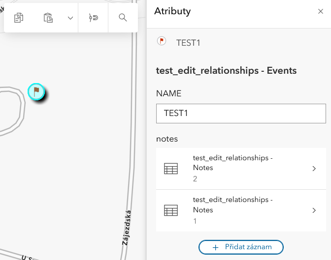

I'm having trouble creating related records in the new Web Editor on ArcGIS Enterprise 11.3.
Click the (create record) button to create a new row in a standalone table through the relationship set in the Smart Form. No errors are logged in the console.
The same workflow works fine in the Map Viewer (using Smart Form), so there's nothing wrong with the data.
Is there anything else I should check?

I noticed that when creating new features in the Web Editor, the GlobalID is saved in uppercase in Enterprise and lowercase in Online, referring to the same Feature Service (hosted) from Enterprise. I mention this because the relationship is created by GlobalID/GUID as a primary/foreign key.
