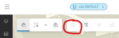

Hi,
Editing tools are inactive, how can i edit operation?

Hello, a few things:
  • Do you have permissions to edit the sde.Default version?
  • You have 16,000+ features selected. The threshold of bulk editing in the Web Editor is 200 features. Try selecting less features to enable Move, Delete or Copy.
Craig
JohnGoat
Hi @CraigGillgrass
Yes i have a permissions to edits operations. I can edit the same web map in the Map Viewer interface.

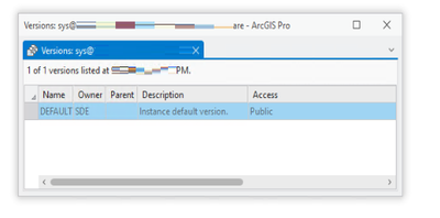

CraigGillgrass
thanks @JohnGoat - is the sde.Default version Protected?
JohnGoat
@CraigGillgrass
Thanks
No it is public access

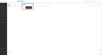

CraigGillgrass
thanks @JohnGoat a couple other questions
  1. Are the editing tools enabled when you have 200 or less features selected?
  2. Is the Create Feature tool, the first one on the Primary Editing toolbar?  In your screenshot, you've opened the Utility Network toolbar, so I can't see what the Primary Editing toolbar looks like.
  3. What is your User Type and Role for your named user?
thanks
JohnGoat
1.The situation is the same when I select 1 feature.
2. Yes, As I mentioned in the screenshot, the editing toolbar menu is inactive.
thanks @CraigGillgrass
3.  I have a creator user type, Advanced editing add on added to creator.

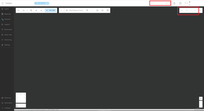

CraigGillgrass
ok, I think I see the issue @JohnGoat - there's an issue we're working through with respect to licensing of the Web Editor at 11.3.  Let's take this over to email so we can sort through this, can you email me at [email protected]

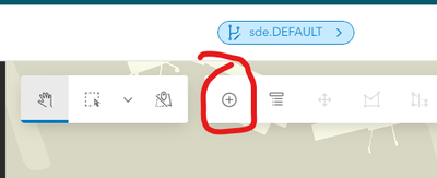

lzorloni
Hello Craig,
I think I have the same problem, but I found a not so good "solution"...
When I open the web map in web editor the "Create" and the editing buttons are inactive for me too:
If I go to the Versioning tab, change to another branch version and go back to the Default version, it seems like it fixes.
Maybe a bug?
Thank you,
L
CraigGillgrass
Hello @lzorloni yes, that is a known issue in Web Editor at 11.3 and you're solution is the way to workaround that particular bug.  I'll elevate this issue and see if we can get it addressed for the next release.
