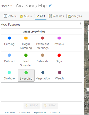

Is there a way to manage feature templates in the web editor? Since the June 2024 AGOL update the manage button has disappeared in the map viewer classic maps. I would like to move the workflow into the web editor or map viewer but can not find a way to manage the feature templates.

If it hasn't been removed, where is it hidden now?
This seems to be across the board with ALL web maps I tried.

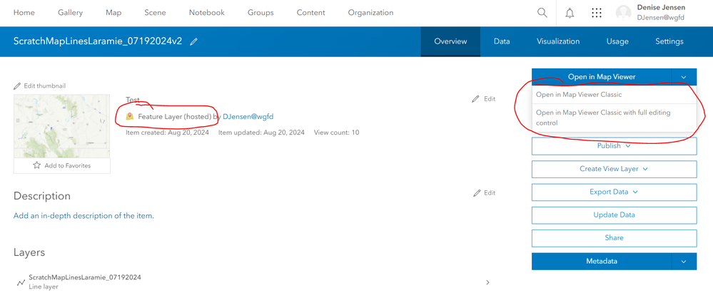

I submitted the ticket to ESRI and this is what we found out. If you open an existing Map Viewer Classic map the manage button will not show up. If you go to the feature layer Overview page and on the right say open in Classic then the manage button will be there.
They have submitted it as a bug but with Classic going away, it may not be fixed. They have also reached out to the Map Viewer team to see about getting the manage button in Map Viewer as a higher priority. So we will see what happens.
