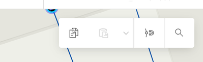

You should see the Copy/Paste tools in the upper right hand corner of the Web Editor, under your named user dropdown.
Screenshot 2024-08-12 at 10.07.35 AM.pngScreenshot 2024-08-12 at 10.07.35 AM.png
