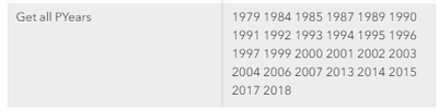

Awesome starting point. Changed my layer and field names and tested it out with the below results.
Just need to work on it a bit to filter out the "0" values (where no Year value exists) and sort from oldest to most recent (as well as the formatting to just return a value instead of the table and "text" values).

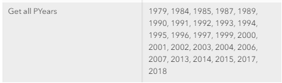

And further modified to separate with commas and spaces ', ' (Line 13) plus removing the last comma and space (Line 16) which negates the need for the Trim function which only removed the original trailing space.
var poly1 = FeatureSetByName($map, "FPC Plantations")
var intersects = Intersects(Geometry($feature), poly1)
var distinct_planting = []
var display_output = ""
for(var f in intersects) {
  iif(f['EstabYear']==0,"",Push(distinct_planting, f['EstabYear']))
distinct_planting = Distinct(Sort(distinct_planting))
for (var pyear in distinct_planting) {
  display_output = display_output + distinct_planting[pyear] + ', '
return(Left(display_output, Count(display_output)-2))
