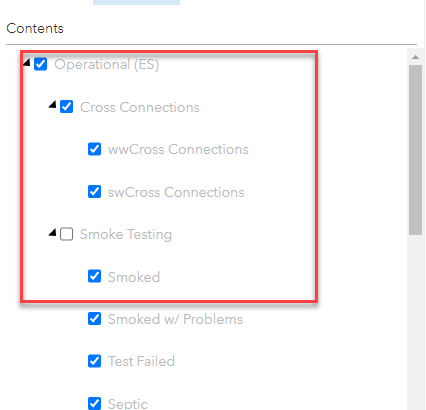

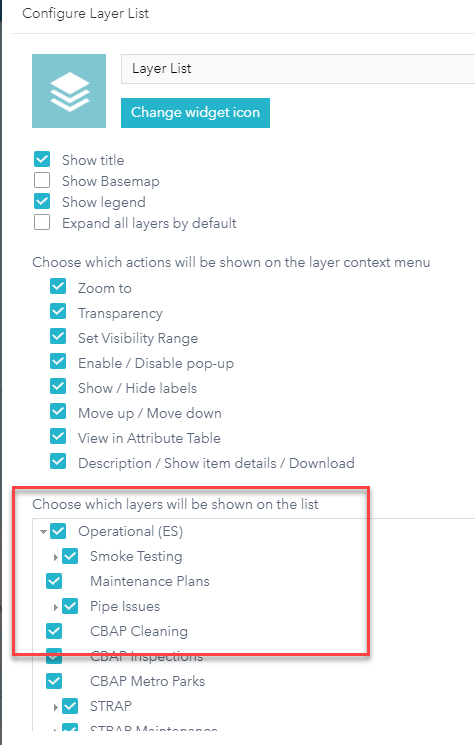

I recently was asked to add additional layers to a web map which feeds into one of our WAB-DEV apps. I can see the layers in my web map, but when I go into the web app builder to configure these  new layers in the app, I can't see them! I have checked over and over that I am looking at the correct reference map in the app, but they aren't matching up.
I took a look around the config files, but I am not totally sure where to look for to adjust things?
Has anyone had this happen? Or know how to fix this issue?
Here is the web map:
Here is what the widget is seeing:

I figured it out! I had to mess around with the map image layer's json in ArcGIS Online Assistant. I thought I had everything showing properly, but it wasn't. You used to be able to overwrite a service with new layers in it and it wouldn't require any messing with the json, but???
once I got that dialed in, everything showed up as expected. Thanks again for your reply. I appreciate it!
