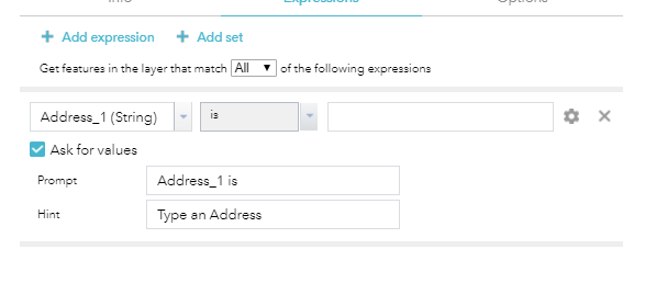

AlexP_
See screenshot What I input. Am I doing this right? This is fliter widget.
XanderBakker
Esri Esteemed Contributor
If you use the "is" operator you will have to provide the exact address in order to get a result.
