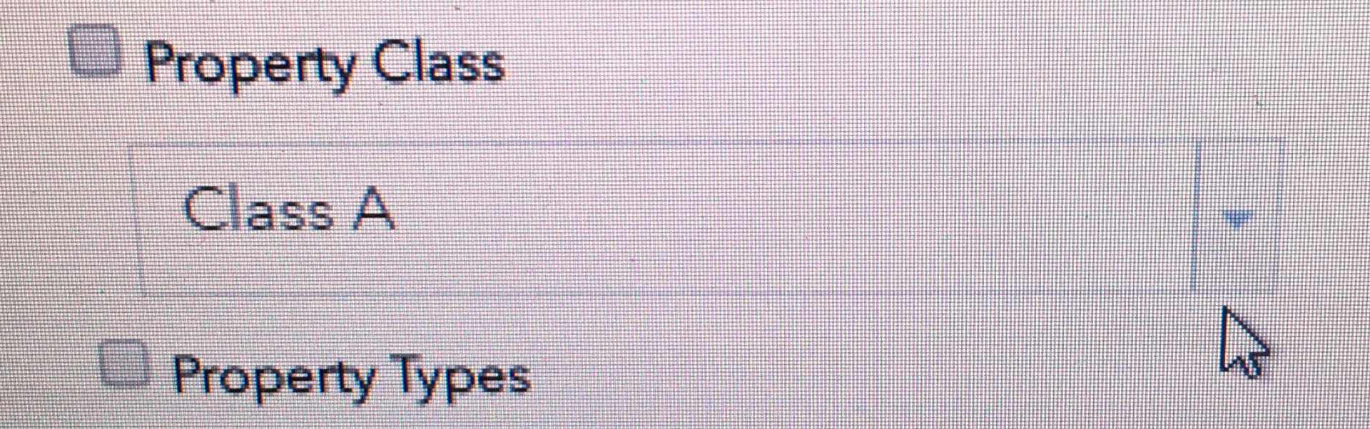

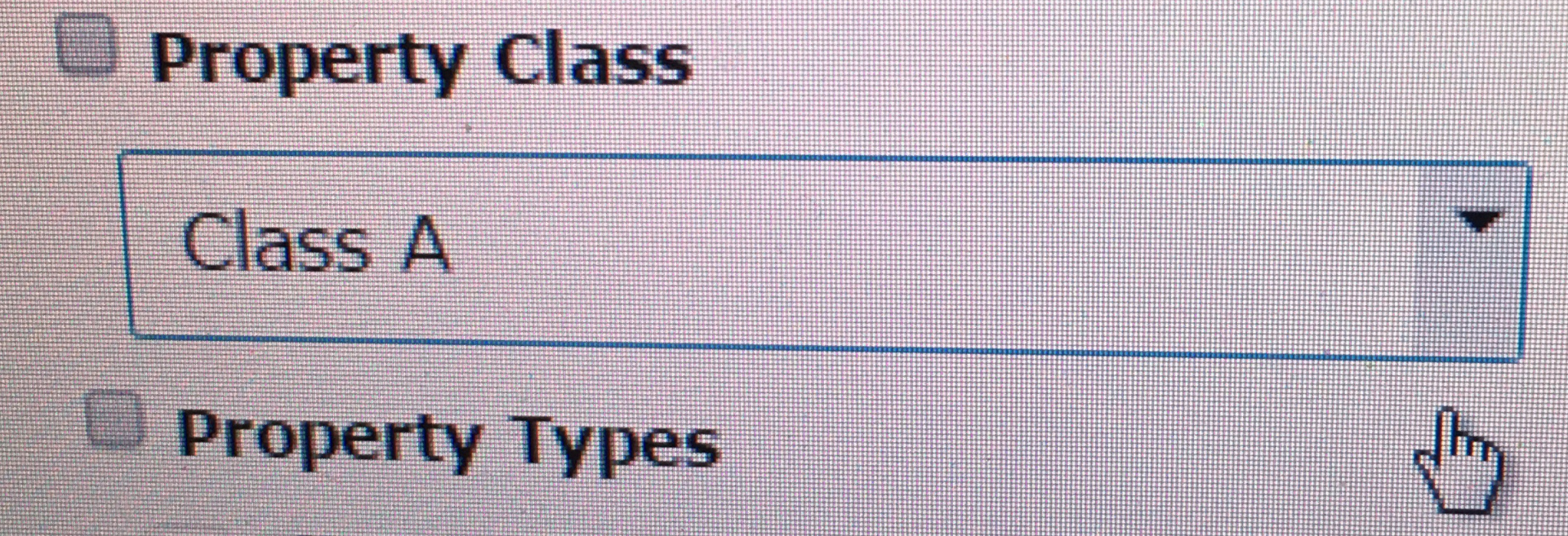

Hello, I have a dijit/form/ComboBox in my LaunchPad theme app. The combobox works, but the weird thing was that the control still got focused even when I moved cursor below the box - please see below. When I click it, the drop down list opens. When I change theme from LaunchPad to a Tab, I didn't notice any weird behavior. I assume the LaunchPad theme adds some styles to the dijit controls, is there a way to remove or overwrite these styles? Thanks for your help.
LaunchPad theme:
Tab theme:

   I am not seeing this behavior on my end. In you image do you notice that your mouse cursor is a pointer still? When you mouse cursor is a pointer over a combobox the combobox is in hover over mode and thus still get the focus rect around it.
