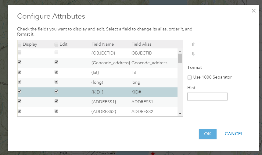

Hello,
I have a Web AppBuilder application that displays commas in numeric fields that have been configured to not display commas for values larger than 1000. We have also configured any date fields to be displayed as Month, Day, Year format but this does not format in the application as well (2nd image)
We have built a Web AppBuilder Application that uses the Jewel Box theme with the Smart Editor widget added to the left pane. But the values keep displaying with a comma. Second image is from the date field that is not formatting to our selected format.
We are using the developers edition and i am hoping that somebody could help us out by identifying which files need to be adjusted with some code. Similar to Liana Smith's issues
Thanks
