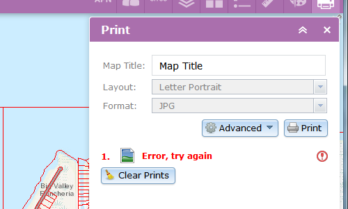

I'm having an odd issue trying to get the print widget working in Web Appbuilder on our Portal site.
Some background:  I've successfully managed to get it working in a series of applications, using a print service I published in Server.    One example is:ArcGIS Web Application
All of the map services and print service I'm using are on our public GIS server.   What I am trying to do now is the same thing, but using a map service published on our internal server (requiring employee login).    When I set it up the same way, pointing to the same print service, Task: Export Web Map  , all I get is an error message when trying to use the print widget in Web Appbuilder.
Does this have something to do with the fact that one of the map services is on an internal server, requiring login from our internal domain?  If so, how do I resolve this so I can print from the application?

Lon,
  The issue is that the map service is on an internal server and is secured. You mention that the one map service is on an internal server. Is its url accessible like your public server, but it just requires a login?

Robert,
Yes, the url is accessible on the same public server.   ArcGIS Web Application
It's one of the map services that requires login, and it does seem that it is what is causing the problem:   If I skip the login (as you'd have to do) and not load that service, I can print with no problem.   If I login to that service, it throws an error when    printing.   Unfortunately I still have no idea how to resolve it.   I even tried creating a print service on that internal server with the same templates, but I get the same problem.
I had seen the thread you referenced, but dismissed it as the solution there was to make sure the print service is set to Synchronous in the Execution Mode, which I had done when I initially set up the service.

Lon,
  Have you setup a proxy so that it will pass the credentials for the layer to the map service?

BTW, it finally occurred to me to check the logs on Server Manager, and it confirms that the secured service ("Owners") is the problem:
Error executing tool. Export Web Map Job ID: j12df57fe3e8041368423da3cfbcd04b3 : Layer "Owners": Unable to connect to map server at http://gisprivate:6080/arcgis/rest/services/Owners/MapServer. Failed to execute (ExportWebMap). Failed to execute (Export Web Map).
