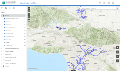

Here's what I mean.  The app below was just refreshed.  It is on my machine where I configured the web app, but the browser window was made smaller.  The map features are cut off.

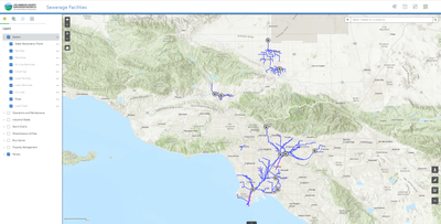

When fully maximized on my machine, it looks like this.  I understand the browser window may change size, but I would think the initial app extent should always be visible on load.
