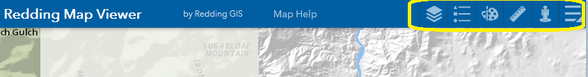

None of the widget icons display across the top bar? this does not appear to happen with our Esri hosted apps.  I tested compatibility mode and it did not resolve the issue.
If I shrink the browser window (by minimizing) the widget icons show up.

   The workarounds has already been mentioned here. In the main config.json replace all the \\ with /. ie.
"icon": "configs\\Medford Land Information\\icon_widgets_Medford Land Information_Widget_37.jpeg",

  2.4 had an issue with icon placement. The icons are actually there but just below the header on the map.
