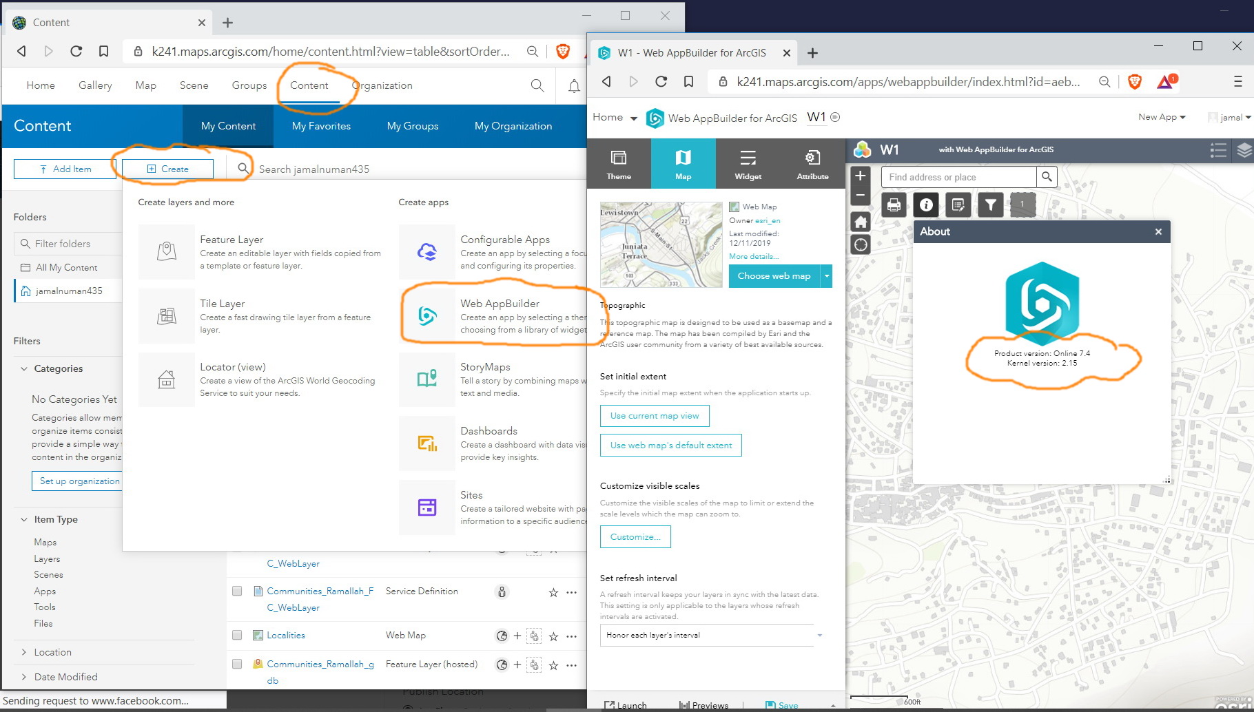

Web App Builder (WAB) 7.4/ Kernel 2.15: How to download and install the WAB in local machine instead of having web mapping app built in cloud?
2788
5
03-15-2020 02:23 PM
JamalNUMAN
Legendary Contributor
I’m not sure if there is a way to download and install the WAB in local machine instead of having web mapping app built in cloud the same as we do for ArcGIS Online versus Portal for ArcGIS

JamalNUMAN
Thanks Archit.
What I’m referring to here is to be able to install the off-the-shelf Web App Builder software in our local machines that has the exact functionalities as the one available by esri cloud.

JamalNUMAN
Manty thanks guys for the help. I managed to install the WAB 2.15 on the local machine and it appears to have the same functionalities as the one available on Cloud
