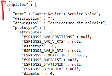

Yes. I removed 2 fields. While I was waiting for a response here I looked at the JSON of the service to see if I could detect something there (easy, right?) and I was grateful to have noticed that the feature template portion of the code shows each field. The 2 fields I'd deleted were still showing within the template.
I was tempted to wonder if I removed (or commented out) those lines, would my service (and it's apps) begin operating correctly again. I didn't have the courage; instead, remembering something within one of these threads that suggested putting the attributes back into the schema, hide and disable editing on the fields, and this might correct the issue.
It did. I replaced the fields ensuring they were not being seen anywhere or edited, and it started accepting updates to records in the Crowdsource Manager. So, I was able to triage and correct the issue but still left wondering about the JSON definition update idea I had. Would removing the field references in the JSON configuration (I didn't see any other field references for the 2 deleted) would that have corrected the issue as well?

Reviewing this conversation again, and thought I'd drop a note regarding templates:
The Smart Editor uses the templates for editing, and you may experience issues if these are missing (which can happen if a field is added manually to the JSON without adding the attribute in the templates, or if a field is hidden using Survey123 by modifying the type rather than the appearance of the field).
E.g.
