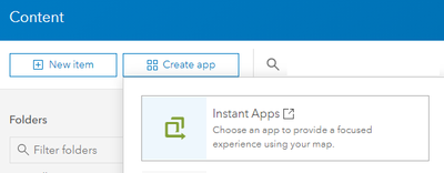

Hi @MityV758 , I agree with @RyanBohan  and his suggestion will give you the greatest flexibility in the long run. You could also consider the newish "Zone Lookup" Instant App if you're using ArcGIS Online.
Create app >> Instant Apps
