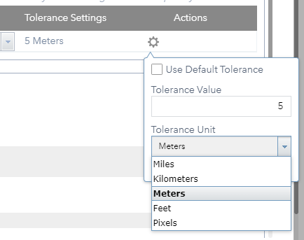

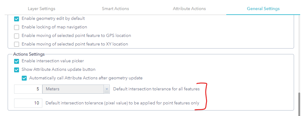

AlixVezina
Hi Pam,
When setting up an intersection line or polygon against a point layer, please use the other tolerance units. Pixel tolerance will only apply for point to point intersections. This can be configured directly against the layer in the intersection attribute action or in the layer settings (in this case check the box for "Use Default Tolerance").
