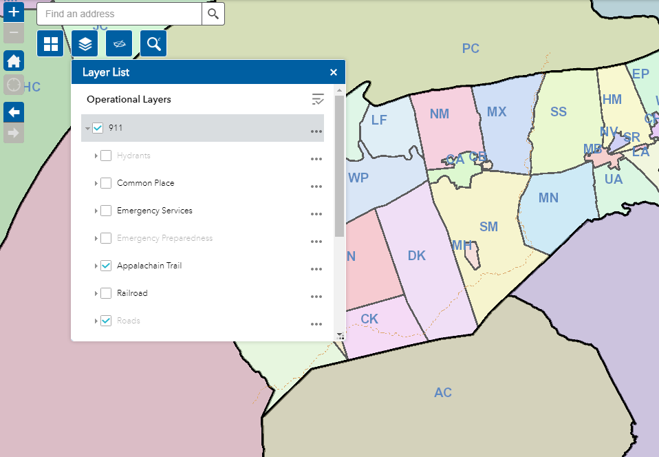

I'm developing a WAB app using Developer edition 2.4.  I had a couple questions about the Layer List widget:
1. Is it possible to have the widget open when the map first loads?
2. Is it possible to have a map service containing sub-layers to be expanded by default? I have an image of what I would prefer.
list layer widget expanded by default screen shot

PatrickMcKinney1
Thanks! Not sure how I missed that. I ended up using a CSS trick to have the list expanded:
/* Layer list expanded by default */
.jimu-widget-layerList table.layer-sub-node {
 display: table;
/* layer list legend hidden so it loads properly */
.jimu-widget-layerList table.layer-sub-node .legends-loading-img {
 display: none;

PatrickMcKinney1
I've added a Gist on GitHub with the CSS rules for achieving this.  I always create a style.css file for each WAB project, where I store the default rules in the style tag, along with my custom styles.
There are two rules to achieve the result. A sample map can be found at  911 CAD Map .
