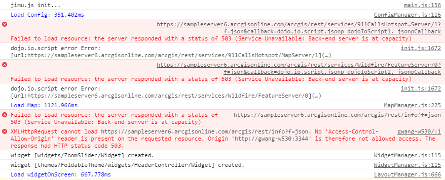

HI, got message below when using WAB dev edition. I can browse the service via rest url, but it said the services are not available. Can anybody tell me how to change these services (911CallHotSpot and Wildlife) behind so i can use my services? Thanks,

Alex,
   It is the webmap that that json is calling that has those urls. So if you want to fix that then you need to modify the config-demo.json and change the maps itemId to one of your own web maps.

Alex,
  What sample widget? can you give more details?
Alexwang
Robert, the default web map when I was testing via http://mycomputer:3344/webappviewer/?config=sample-configs/config-demo.json
I am using WAB dev edition 2.0
RobertScheitlin__GISP
MVP Emeritus
Alex,
Alexwang
Thanks Robert. you helped!
