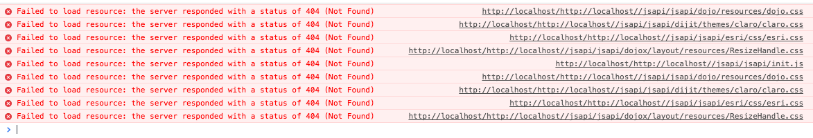

  5. the application fails to run on the Mac, with multiple 404 errors:
404 errors
eg: http://localhost/http://localhost//jsapi/jsapi/dojo/resources/dojo.css Failed to load resource: the server responded with a status of 404 (Not Found)
Why is the path referencing localhost twice (http://localhost/http://localhost//jsapi/)? Note that this doesn't occur on the Windows machine.

Hi Steve,
I guess you don't set apiUrl manually. If so, WAB will calculate apiUrl automatically.
Mostly, when you deploy the app, you should set apiUrl in env.js as the following screenshot.
Have a try.

Hi Steve,
Have a try.

Hi!
This error has also happened to me on windows!
QunSun's solution worked for me but I've seen that code is commented only if you copy the app from the server/apps folder. However, if you download the app of the WAB itself, everything comes without comment and is ready to deploy.
