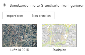

Out of that I bulit a Web App with Web App Builder and added the "Basemap Gallery Widget".
What I want: When starting the app, the basemap used in the web map is shown and when I open the "Basemap Gallery Widget" I want to have the choice between "Stadtplan" (city map) and "Luftbild" (arial photo).
What I did: I added the two basemaps into the widget ... "Luftbild" and Stadtplan". I did that because I wanted to add a self generated small picture for the Stadtplan-basemap and not the automatically generated that comes up, if I only add the arial-photo as basemap.

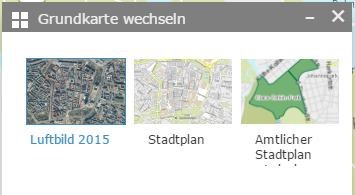

But this is what happens: When I open the widget it shows me three basemap to choose from.... the arial-photo (left), the city-map (middle) and the city-map generated out of the web map (right).
What I could do: Delete the manually generated basemap "city-map" from the widget (middle in the picture).
Why don't I? Because I don't like the look of the automatically generated picture, because it does not just show the basemap, but the basemap with the content of the webmap above it.
So I want to delete the automatically out of the web map generated basemap out of the "basemap gallery widget".
