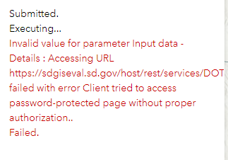

I have created a geoprocessing service using Python and the ArcREST API that manipulates data in a secured service.
The problem is that when i try to have the user select a layer on the map (if it comes from a secured feature service).  I get the following error:
I can get around this by having the user supply the URL to the service as a string.  The script generates a token to use the apply edits feature of the REST API, but if I don't use a string parameter the script crashes immediately, even though the token is generated prior to the parameter ever being used.  However, users rarely know the URL of the services their editing and want to be able to select things straight off of the map. This is a requirement of the client for whom I am building this.

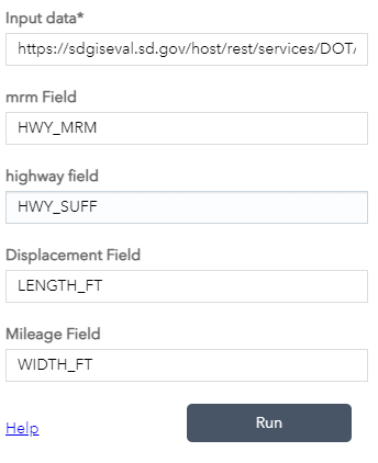

NickSwartz
gui.PNGWhen I set the input data to be a URL string, the tool works great.  It's only when they select the layer from the map that there is a problem.
LongDinh
Hi @NickSwartz
Thanks for the information.
Is the geoprocessing service shared to the current user that is logged into the Web Application?
We can try determine the authorization error by seeing what the Geoprocessing Widget is trying to request by logging the browser interactions. Some options to log network requests are:
  1. Use the Web Browsers' developer tools (hit F12 to open), or
  2. Use Fiddler 4 (which may require some setting up to proxy between your machine and your secured network so I won't go through this - a handy web logging tool to explore in the future).
Web Browser
Can you open up your Web Browser's developer tools (hit F12 for shortcut)  and go to you Network Tab. Open up your Web Application and just before you select and layer and execute your tool, clear the network log.
Run your steps and your developer tools should log the requests.
The Select Widget should send the Query and the Geoprocessing Widget should send an execute. Select a request and view the body/request parameters and see if the package sent to the Geoprocessing Service matches what you have intended to send.
The execute package should have a token parameter. Test if the token works in incognito mode.
The Geoprocessing Widget might also log it in the console tab so maybe check out what messages are in there too
