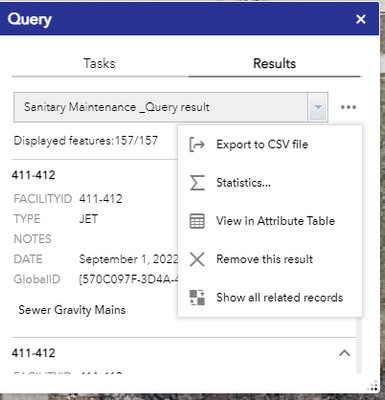

I have been wanting this also and now just today I found a Show all related records button on the Query widget in a AGOL App (not a map but an app).  Not perfect but at least mostly does it.
BugPie
Thanks for pointing this out Doug. I'm been scratching my head for hours trying to figure this out from with the Query widget. I was about to throw in the towel when I clicked on that icon.
FWIW, not an ideal way to get there, however it get's the job done which at this point is all I need.
BrandonLee1
I realize this is a 4 year old thread. Wondering if any of you have been able to see the entire relationship between a related table and a feature?
My results from a Query on the table below... My goal is to create a "report" of the monthly query on the sewer mains.  I'd like to be able to use the TYPE field below (on the related table) to sum up the length (on the feature) of sewer main.
