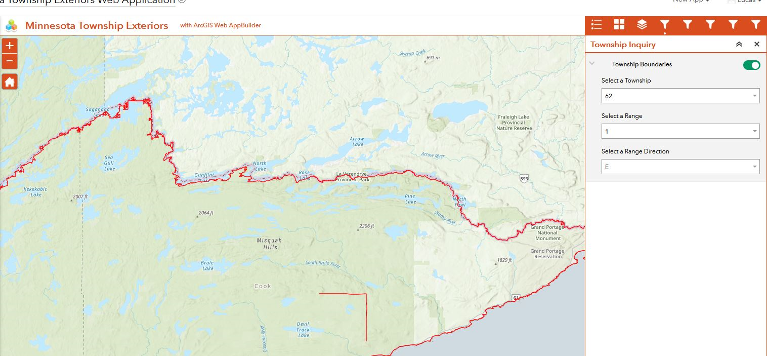

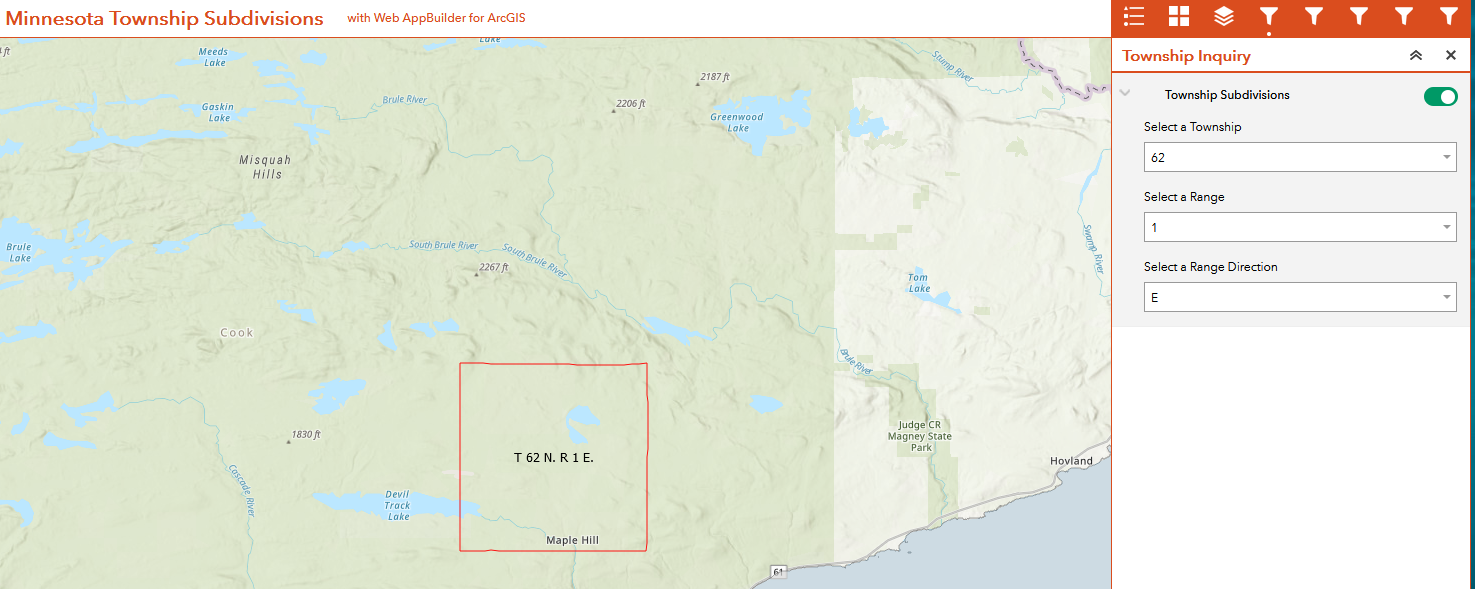

I am using the Filter Widget in a Mapping Application. I currently have two maps: one for the 2D Townships (Subdivisions) and one for the 1D Township Boundaries (Exteriors). I am trying to allow the user to filter (called "Township Inquiry") by Township, Range, and Range Direction. It works for the Subdivisions but not for the Exteriors because the Exteriors cover more than one township (see images).
I have another field that has the other half of the township, but the filter won't allow me to select both fields even though the value is the same. Is there a way I can do this?
