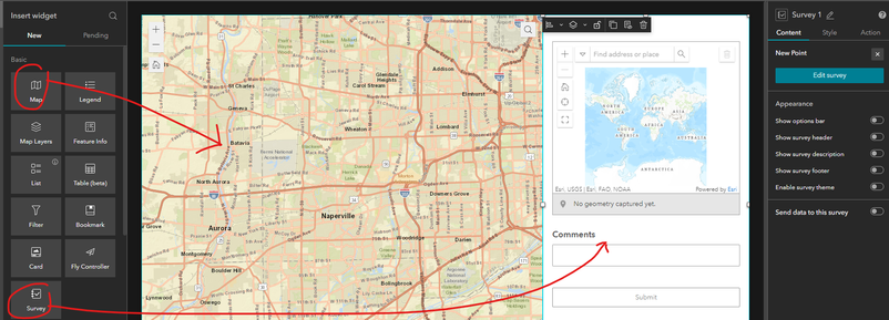

Otherwise, if your workflow mainly requires the public to create new point features and view them on a map, I suggest exploring the option of creating a simple app with a form in Experience Builder. The builder allows you to add an existing survey from Survey123 or to create a new one, and you can also add your web map to the side that reflects the points layer with the points being collected in the survey.
This may require a little more configuration time from your end, but may be more user-friendly based on your user's needs?

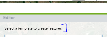

Unfortunately, no direct solution. We did end up revising this text here with descriptive instructions on how to use the widget. You should be able to edit this text from the Portal/AGO Web AppBuilder without needing the developer edition.
