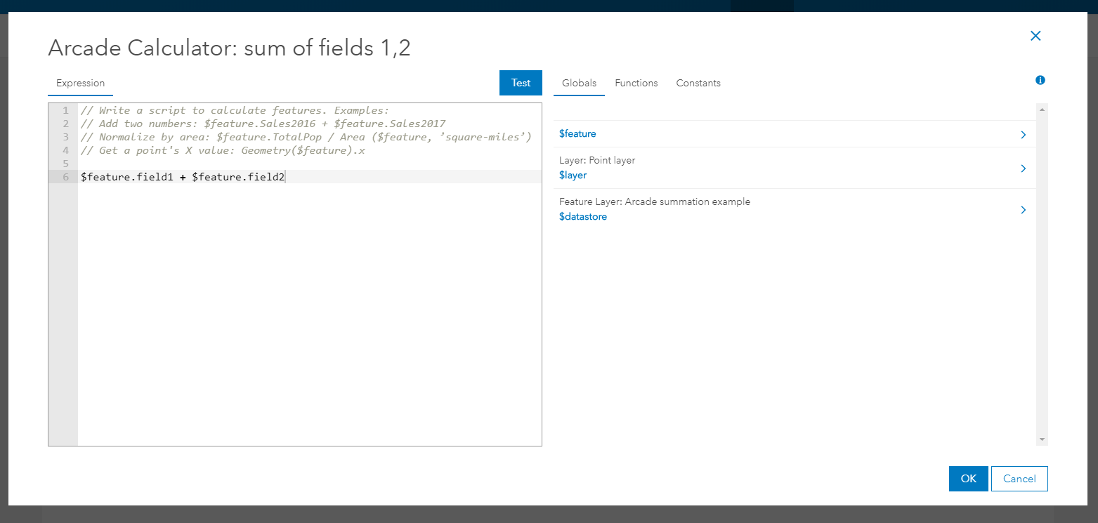

There is also an option to set up an Arcade expression to generate the sum for these fields. Here is a blog on this topic: Create Custom Field Calculations Using Arcade Expressions

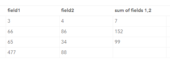

Here's an example:
1. Calculate the field:

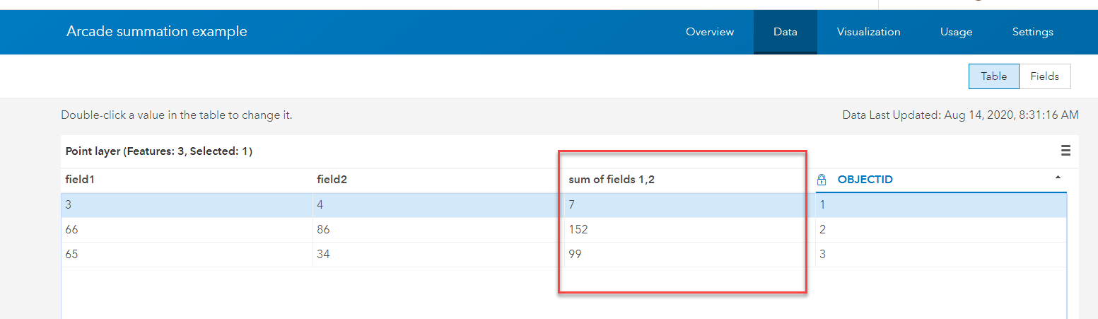

2. Get results:
BUT, when using the field calculation from the layer's Data tab, values are calculated and written into the field but won't be generated on the fly as new features are added.
You will need to trigger the field calculation again to update the values. You can find a way to automate this process. Maybe there is a way to automate something like this with ArcGIS Notebooks? ArcGIS Notebooks  -- this needs more investigating.
