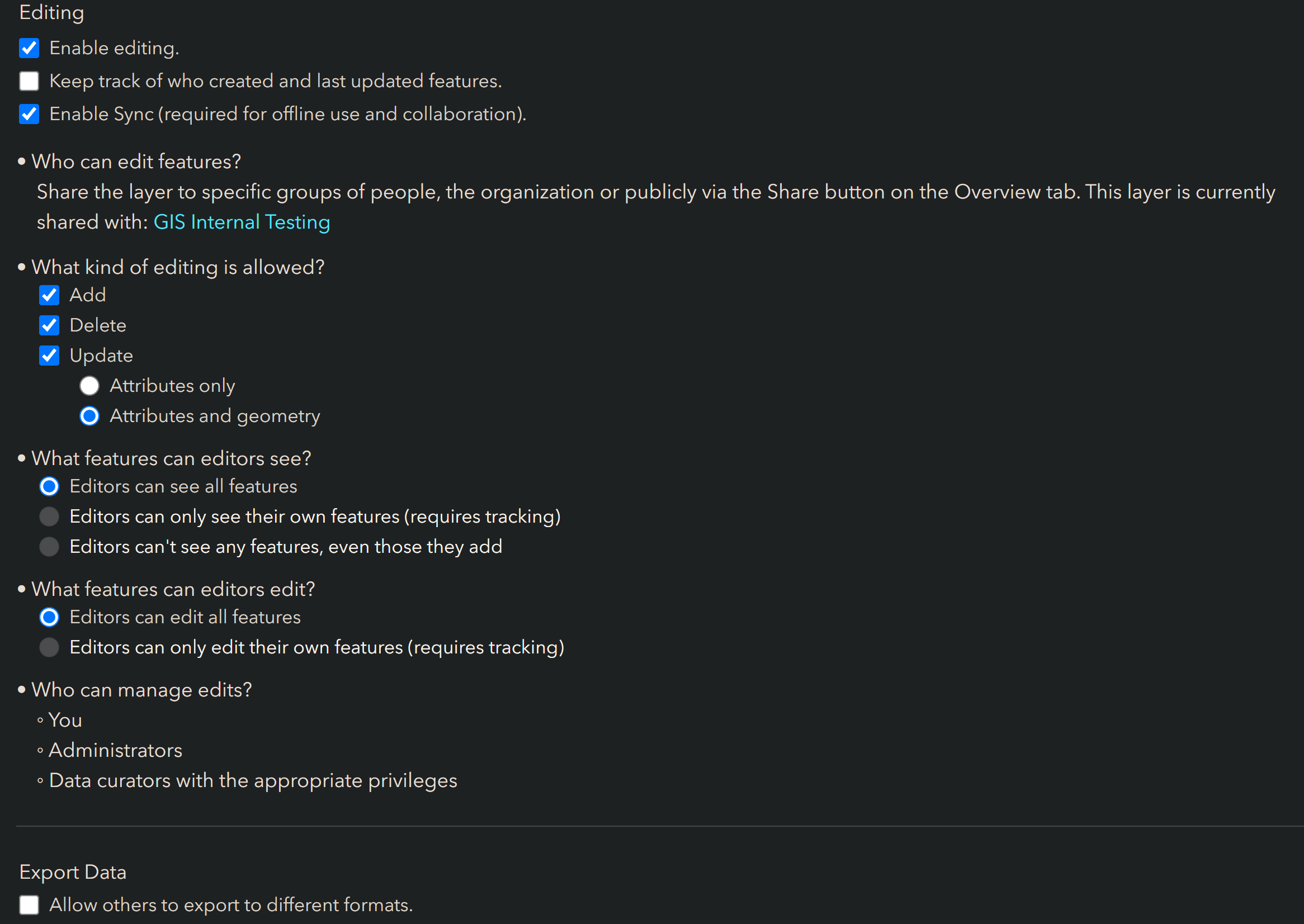

My goal is to have the ability for users to drop a colored pin on the map to "tag" a location. I created a hosted feature layer for this purpose (on my Content tab, I clicked "Create" and then "Feature Layer"). The feature layer is empty. I shared this layer with the group as well, and added it to the web map. The sharing settings for the layer look like this:

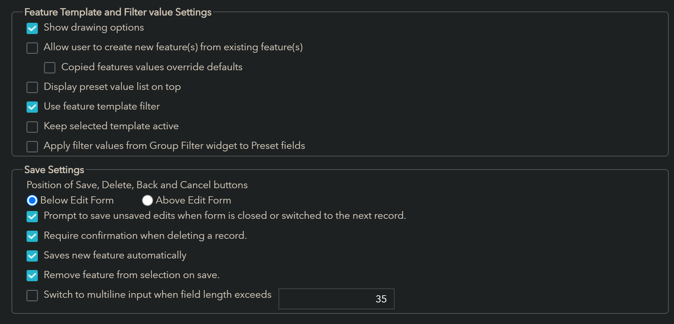

In the Web App, I added the Smart Editor widget. The "pin" layer--and only the pin layer--are checked as "editable" in the widget settings. "Allow delete" is also checked. The general settings tab looks like this:

Ah, I see what I did. The other users have Viewer accounts. Is there any way that I can give them permission to edit only that one single layer, as opposed to everything that is shared with them? They need to be able to view the other layers, but they should have no ability to edit them. If I make them a Creator account, they'll be able to edit other features in other layers, which scares me.
The only persistent change I want them to be able to make to anything is to drop a pin on a location (with that pin only being visible to their group).
AlixVezina
The only layers Viewer users will be able to edit are layers shared publicly (with everyone) and with public editing enabled. If you were to change these users to Creators instead, you should be able to restrict editing from the Smart Editor widget configuration in the application, or simply disable editing for that layer in the layer settings.
