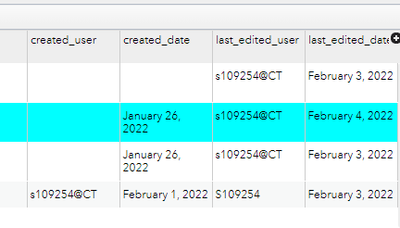

LefterisKoumis
Sure. Here you go. Thanks.
This is from the AT in WAB
This is the AT from the web map with the timestamp as well.

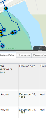

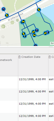

AlixVezina
I have compared the attribute tables for one of the feature services I've published to my own Portal, and I am also seeing the same thing:
In the web map classic, in the table for a given layer, I can see the timestamps:
But when I look at the attribute table from the Attribute Table widget for that same layer in Web AppBuilder, the timestamp is missing and the date format is different.
@Wei_Ying  Do you know if this is a known limitation for the Attribute Table widget?
