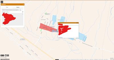

That's strange because when I put 3 or 14 I haven't seen a difference.
and to make sure that I'm describing it correctly
I want to set the closer zoom to the searched point after choosing it from the result list on the left. Without having to click "Zoom in" in a popup window.
