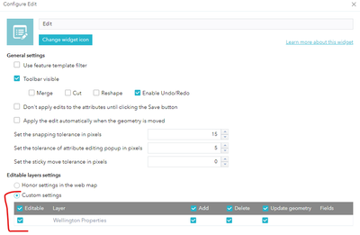

The option to open the Edit widget from the pop-up will only be available if the feature you have clicked comes from a layer which
  • has editing allowed from layer item settings or at the service level,
  • it also needs to allow editing form the settings in the web map (click more options ... for the layer and then Enable editing)
  • and then you may need to set the layer as editable in the Edit widget configuration, depending on what were your web map settings.

Hi Alix,
Thanks for the recommendations. I went through all those options and it was the Editable Layer settings for the widget.
Initially, I had the "Honor settings in the web map" selection checked. Switching to the "Custom settings" configuration and selecting those layers I wanted editable did the trick, the Edit option reappeared in the popup.
