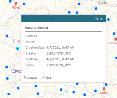

When I create the web app, there doesn't seem to be any option to edit the relevant attributes!? I did this successfully two years ago, and it was easy, a member of the public, upon opening the map, could simply select a survey zone of their choice where a pop-up appeared, showing the attributes, and allowing them to edit the relevant ones to claim it for themselves.
Now, the pop-up appears, but there is no option to edit the attributes. I must have missed something but I can't see what it is. Can somebody point me in the right direction? Thanks

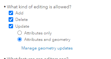

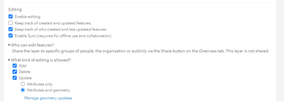

Go to the hosted layer page. Then find the settings on the upper right.
Scroll down to editing options. You will probably want attributes only.
JamesONeill
Yes, I have selected all the right options in the settings of the feature layer to allow public editing of attributes only. Still, it's not allowing for editing in the final app.

Thankyou! that has certainly made it editable. Unfortunately this certainly isn't as user friendly (especially for those using phones) as the way I had it before where you didn't have to click edit - you could just edit it as soon as the attribute box popped up without extra steps. Given that this is aimed at volunteers who may not be totally tech savvy, I wonder if there is a template which is any more user-friendly.
But thankyou again for pointing out what I had missed.
JamesONeill
Thanks again, but the more I work with this, the less user friendly this method of editing is - in fact it's downright awful on a phone. It was so easy before using the same basic template - select, edit, done - like in this video: https://www.youtube.com/watch?v=w768Kk_Elq0&t=33s
Why did they change it!? Would you know of any easier templates?
