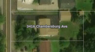

Here is an example of what a particular parcel looks like:
Parcel not selected

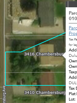

If I zoom out and click on the parcel, the boundary is highlighted in the cyan color as expected but if I zoom in and click on the parcel I get a strange selection polygon that doesn't resemble anything I recognize.
Strange selection outline

Andrew,
   What version of WAB and what version is the ArcGIS Server where your data is coming from?
AndrewHayden1
WAB 2.9 and ArcGIS Server 10.7.1
RobertScheitlin__GISP
MVP Emeritus
Andrew,
  Seems like I remember one of the older versions of WAB having this issue with generalizing the selection geometry. You should try the latest version of WAB.
AndrewHayden1
Thanks Robert.  That appears to be the issue.  Tested in 2.9, an issue.  Tested in 2.14, not an issue.
