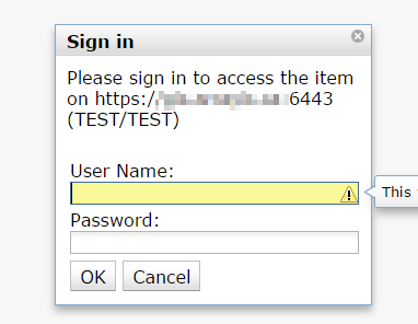

4     Web Map prompts user for credentials for the secure service  - SO far this looks promising

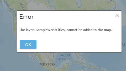

and Now I went back to the Web MAP, and now not able to add https://gis.arrayis.ca:6443/arcgis/rest/services/SampleWorldCities/MapSer…
Ghosts I tell ya!

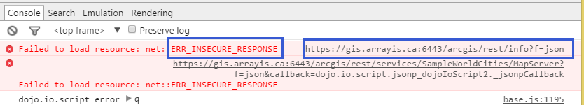

By test, I can't add the service https://gis.arrayis.ca:6443/arcgis/rest/services/SampleWorldCities/MapServer into mapviewer of AGOL or Portal. I should be certificate issue. When I try to add this service into mapviewer, Chrome console shows the following error.
It indicates the https request to your server is blocked because the https request is insecure.
To make it more clear, you can paste the service url into a new Chrome tab, you can get the following screenshot.
I think maybe your server is using a self-signed certificate. You'd better use a signed certificate.
