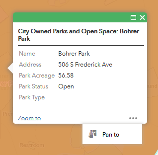

   If you have the directions widget added to your app and loaded then yes (with the AGOL version too). See the attached image:
example
example

Thank you for your reply and the screen capture. You are correct that hosted WAB 'search widget' automatically shows Directions widget option!

   Looking at the code it looks like the search widget has to return a point geometry for those menu options to be available. As far as your other questions I am not sure as I don't use the directions widget much at all.
