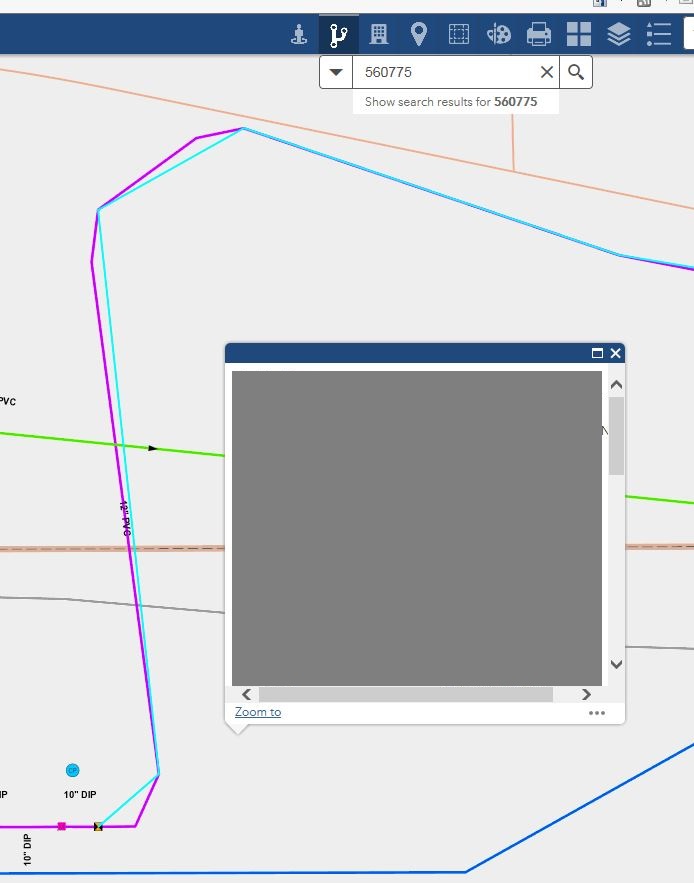

Hopefully the example below is enough to show what I'm talking about. In that picture I am searching for the feature that is marked by the pink line. The search tool finds it properly however the highlighting of the result (The bright blue line) does not fit the line like it should, but rather only fits the line approximately. Does anyone know what the cause of this could be? There aren't any other hidden layers that it could be accidentally displaying in the search result as far as I know.

  It is an intended behavior (currently) The search widget will generalize the returned geometry using maxAllowableOffset of 1 to lessen the amount of data returned from the query. You can call tech support and make an enhancement request to have this configurable in the Search dijit.

Hi Robert, I made the change and unfortunately the error is still occurring.

Thanks for the effort. I made an entirely new app and recreated the search widget and the error is still there so I don't think it's something unique to my specific app. But it's pretty frustrating, there's no way this can be a intended feature of the search tool right?

   So after some in-depth research I have found that the JS API Search Dijit will set the maxAllowableOffset to 1 for the featurelayer that is searched and there does not seem to be any property that can be adjusted to prevent this. Here is a thread where one individual overcame this by hosting the API locally so that they could adjust this property to 0:
https://community.esri.com/thread/178135
